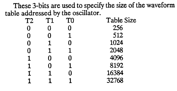

The lowest 3 bits (0 to 2) are for the resolution value and this is only needed for the DOC hardware to get in the right range for the pitch called for. Bits 6 and 7 are for the ROM address decoder, so again we don’t need them. What we do need is bits 3, 4 and 5. These 3 bits describe the code for table size (5 is the MSB). See the chip spec sheet table below.
WSR interpretation .png (24.41 KiB) Viewed 25454 times

So we take the base address (starting address of the waveform) from the Wave ROM page in the spread sheet. Then we look at the 3 relevant bits (3, 4 and 5) to find the size of the whole waveform table, from the table above. Then we divide this size by 256 to find the number of pages used up. If we then add this value in hex to the base address we get the end of file/start of next wave in the ROM.

The start sample number for a waveform is the Wave ROM page number x 256 (all in decimal).
The end sample number is the start number + the sample number given by the table, based on the 3 bit code embedded in the WSR value. Of course it’s a zero-based count so the first sample is numbered 0.

If we look at ROM #2 “bowing 2” the WSR is 74h so the binary is
01110100
which means the length is referenced from xx110xxx and we look up 110 in the table to be a length of 16384 samples which is 16384/256 = 64 pages. In hex this is 40h. The base address of the wave in hex is 40 and, sure enough, the next wave starts at 80h. So this complete waveform starts at sample no. 16384 and ends at sample number 32767 (not 32768 because that’s the start of the next waveform).

- Convert the Wave ROM page number from hex to decimal. This is the Starting position in the next step:
- Start of desired waveform index (sample 0) = Starting position x 256
- Length of waveform is looked up in the table based on the bits 3, 4 and 5 in the WSR entry. (I used the Windows calculator to convert the WSR value to binary first, so I could see the 3-bit code I wanted)
- End of waveform (final sample) = Start of Waveform index + Length -1
