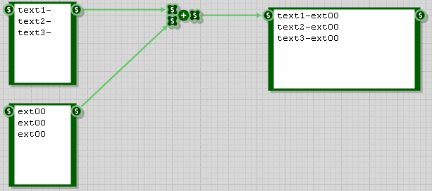

Something is missing in string arrays or I can't find it.
If I have two strings arrays, like that:
text1-
text2-
text3-
and
ext00
ext00
ext00
I'd like to add them as line+line, to get:
text1-ext00
text2-ext00
text3-ext00
But none of these two works that way: "append string array" nor "add" primitive.
How to do it?

Verry simple ;)
add trick array string.PNG (13.34 KiB) Viewed 12233 times
Just "add" both array or connect them to the same plug ;)

Did the same thing and it did not worked, it added second text field after the first one. But I think I know what was wrong. Forgot that the text primitive is not string I/O. Thanks for reminding.

be shure that it is an array
If you connect 2 strings together the lines of the 2nd one will be afterwards and not addet to each line.
