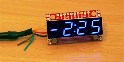

Here's an example on how to comunicate with the SparkFun serial seven segment display:https://www.sparkfun.com/products/11441?
SparkFun LED Display LR.jpg (68.93 KiB) Viewed 96688 times
These are available in Reg, Blue, Green, Yellow & White

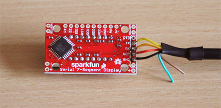

We have connected it to the PC using a 5V FTDI USB-serical cable: https://www.sparkfun.com/products/9717?
The wiring is very simple and can be seen here:
SparkFun LED Display Wiring LR.jpg (88.35 KiB) Viewed 96688 times

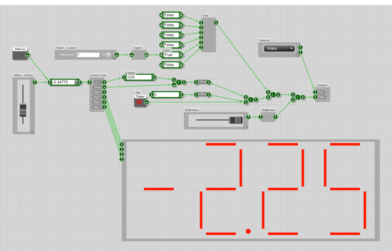

LED Display clip.png (118.47 KiB) Viewed 96687 times
In this example we have shown how to send an +/- number to the display with a flashing colon. It is also possible to send alphanumeric characters to the display.
