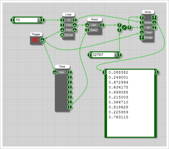

Would the Int Loop component be what you're looking for?
Here's an example that generates 10 pseudo-random numbers:
