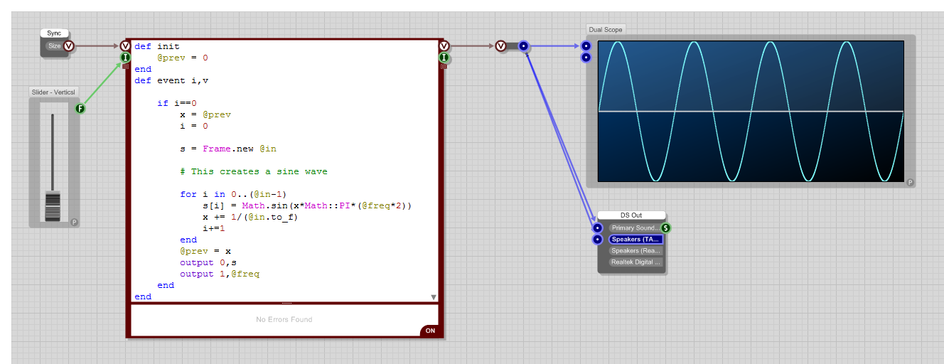

It is possible to do this in Ruby if you use the mono to frames and frames to Mono.
Here's an example of a sine wave generated in Ruby:
Ruby mono to frame sine example clip-2.png (105.27 KiB) Viewed 27746 times
