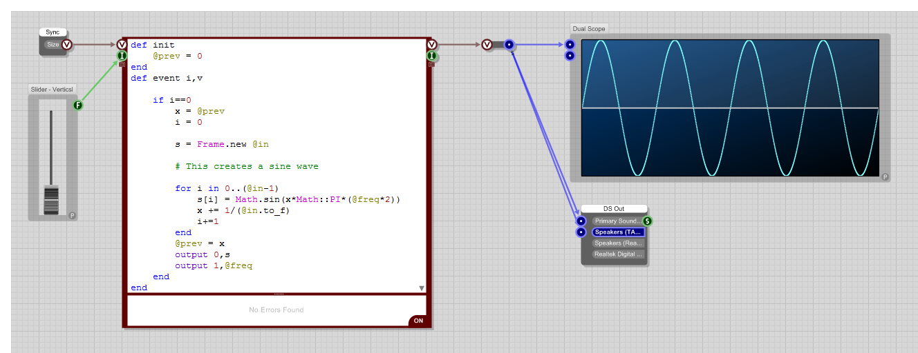

It is possible to do this in Ruby if you use the mono to frames and frames to Mono.
Here's an example of a sine wave generated in Ruby:
Ruby mono to frame sine example clip-2.png (105.27 KiB) Viewed 27735 times
Ruby mono to frame sine example.fsm
(7.17 KiB) Downloaded 1271 times

Dear support, the problem is also with performance of such functions.
Computers have limited speed ;-)
Ruby version would not be suitable neither to my research project that involves multiple generators (even with built in sine osc - I can't use all units at once) nor to my research projects that involves special modulated filters (blue approximation of green version - eats about 3x time of CPU, and ruby version would eat much much more I guess).
