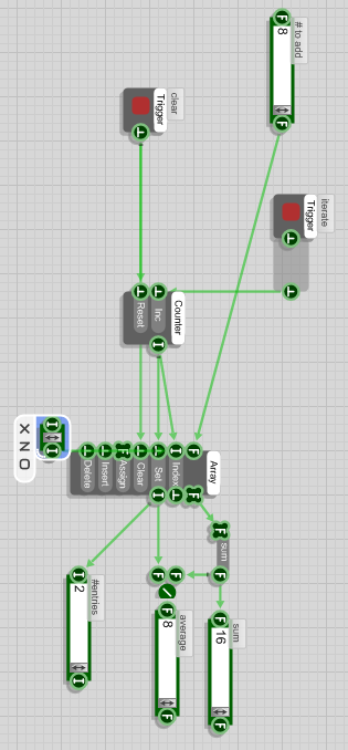

How's this?->
average&sum.fsm
(420 Bytes) Downloaded 1065 times
Hope it works for you 8D

Thanks for the example, my problem that I don't want to build a huge array, just want to accumulate the sum of the values over a long period of time, sorry I realized after I posted that I should have explained this detail. Thanks again for the response..
