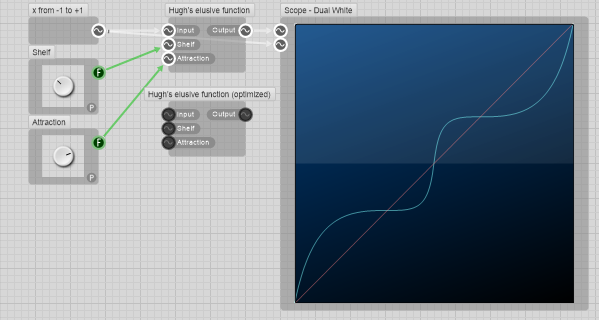

I'm trying to figure out how to turn a regular straight-line control -1 to +1 input (blue line) into symmetrical shapes such as this (red curve) :
The intention is to convert linear stream control values so that they cluster around +or- V. (e.g. as illustrated around +-0.4?)
If it can be done I'd ideally like an adjustable 'cluster shelf' 'V', and an adjustable intensity 'q' (for want of a better term).
As usual my maths lets me down :cry: . Anyone ever done anything like this?

A very interesting challenge! :shock:
I suspect Martin could do the maths and DSP but I would take, as usual, a more pragmatic approach to getting the shape.
Just to clarify, you’d want the top right and bottom left graphs to be mirrored? If that’s the case it might be possible to make a transfer function for the positive-going section then invert the -1 to 0 and pass it through the same function then invert the output. Or something.
I’ve no idea what your purpose is but I can see that a generic module like this would be great for making a variable distortion curve, which is something I’ve given a little thought to already. Let’s see what offers you get…

Yes, positive-negative mirror image, so probably simplifies (??) one element of the task. Might even take care of itself in practice.
I've had this in my head for a while, and very glad I finally drew the diagram yesterday, a quick scribble often brings an idea into focus. Seems clear to me now - also adopting the pragmatic viewpoint - that below the 'v' point (which is where the blue input line and red output line intersect) the output is possibly 1/nth root of the input, and above the 'v' point it's the nth power. Possibly? 'n' would then be equal to what I described as the 'q'. Hah.
I might yet manage something like that. Er ...
My word, a fuzz-box that modified yer smooth guitar signal into this shape would be something to (not) behold! Incoming aliasing alert :!:
However I actually want it for something entirely different, which I'll definitely expand on at length here if it works out. But I'll hang fire for the moment in case it doesn't .. so many of my cunning schemes proceed to the "hang on, I hadn't realised it would do that" stage, and promptly get shoved into my massive reject box :cry: .

Hehe, that's indeed a very specific requirement. Here is my proposal (although, like Spogg, I have no clue what it possibly could be good for :?: ).
Hugh's elusive function.fsm
(14.45 KiB) Downloaded 959 times

OMG!! :ugeek: That is perfection Martin :ugeek:
I did make a start myself this morning with some DSP (honest!), got a quarter of it looking something like, but I guarantee I could spend a month on it and never get it this good (bitmasks and all) nor as streamlined. Thank you .. yet again.
Well, I'd better do something really impressive with it next, hadn't I ... .. .
