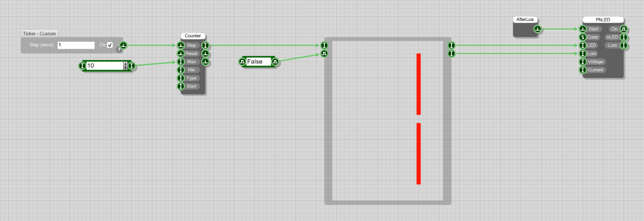

Try this (not tested) but should get you going:
Ruby Seven Segment Display clip.png (46.1 KiB) Viewed 27711 times
Ruby Seven Segment Display.fsm
(2.18 KiB) Downloaded 1129 times
If you wire them up like this:
LED - Segment
0 - a
1 - b
2 - c
3 - d
4 - e
5 - f
6 - g
7 - dp
