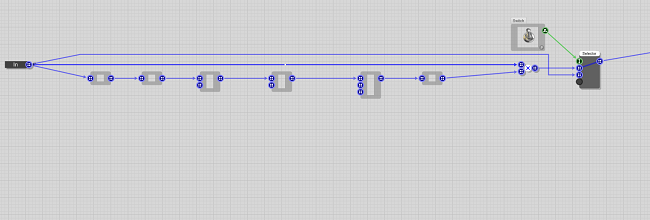

Hey guys, im trying to reduce my cpu consumption in my vst.
As it stands a few things seem odd. It just might be the way FS handles and im just not with it yet.
So my setup is a simple limiter. I take the input and in all the modules, there are just asm code blocks inside, I pass
the audio to attenuate the input. Then a simple switch . You will see what I mean in the pic. . .
So when the switch is on, my cpu reads +- 12%
ok
When i switch off, cpu STILL reads 12% . . . ?!!
I dont get it . . . :cry:
Trog, i know youre there lurking and I have a BIG suspicion you know how to help. . . :P
Anyway, why does it still process even when the OUTPUT of the modules are off?
Or am I getting something wrong here

It shouldn't process, but without your schematic, there is no chance to check what else is wrong

Yes, really we need to see what else is in the schematic (no control parameters in the picture, so cannot be complete).
Are you using any display modules - e.g. indicator for Gain Reduction etc.? If so, that may be the problem - anywhere that you convert stream to 'green' (e.g. mono2float, mono2graph), that will count as a 'live' stream - so you must also disconnect "display convertors", to truly turn off the audio streams.

Thanks for the tips, disconnecting the m2f components did help quite a bit :)
