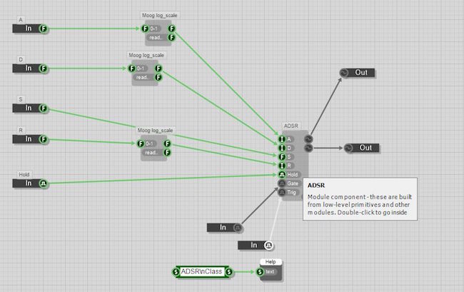

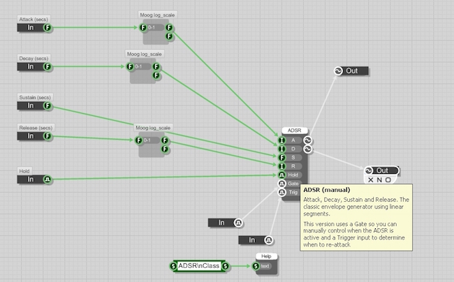

I don't remember how to get on/use Discord (never use it), so I'll just post the screenshots, if they're of any use.
I remembered wrong, it's the 'ADSR (manual)' prim not the 'ADSR4' prim that's getting auto-replaced by the module shown, when schem is opened in FS4.
The attachment Orig.jpg is no longer available
Which looks like this inside:
In FS4.jpg (48.05 KiB) Viewed 15365 times
As you can see my beloved little 'Trig' input has nowhere to go! ; - (
I'd been using the Trig input to do LFO triggering, and the 'Stage' (lower) output of the prim to do 'AD Repeat' (cycling) function.
