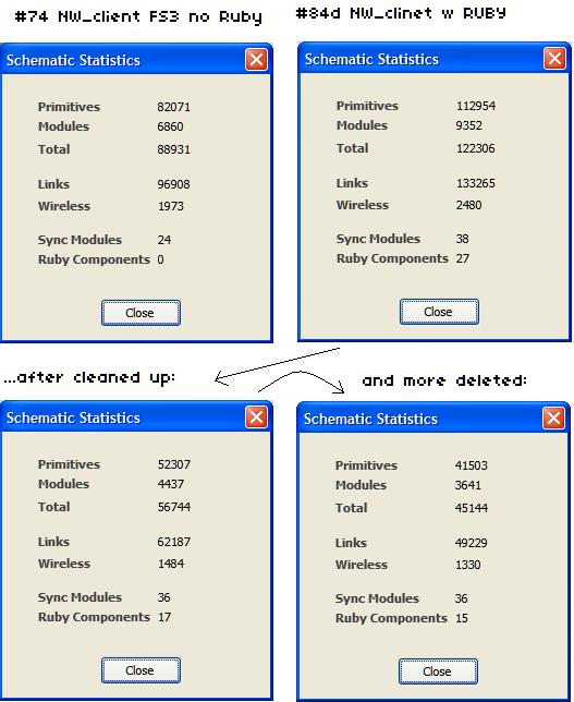

I hoped again with this update i can reduce the CPU use of my projects...
and again have to change many things (trigger behave etc.)
and also tried to get ruby into my old brain:
Now i tested this on my oldie Core Duo and Quads (btw. not every user owns an i7)
FS v1.15 vs FS3:
Even the ruby Level meters halves the comps and Private bytes amount it uses triple CPU power on the Duo and approximate the half of that on the quad (...all w/o the background probs mentioned above)
And the exe is 3.3 MB instead of 1.7 MB in size (ruby overhead - i know...)
FS v1.15 vs FS3:
- NW_client 74-84 statistics.jpg (50.13 KiB) Viewed 31431 times
