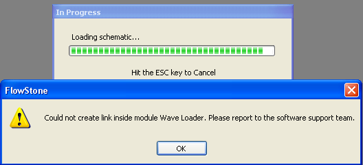

Drnkhobo wrote:You can look at my fsm here:
I got issues here....couldn't open FSM.....locked up CPU, force re-start...???????

:lol:
Old SM Wave player module creating a problem . . . :mrgreen:
Updated here, you should export to vst to check it out.
