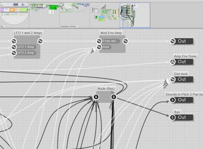

Buses buses buses... :roll:
Trying to simplify and hopefully receive some fractions of performance gains. I'm in the process of reducing packing and unpacking prims.
Below is a big questionmark though. I'm still unsure... Does the bus add same-named values together at junction points... or does it only add them together at unpacking? It would make zero programmatical sense that they would add encapsulated values together (at the bus level) from my logic standpoint.
I think I'll have to do a controlled test to make sure how they behave...
I know variables for example usually are assigned cryptic names inside when code is compiled... so I suspect buses themselves also are kept separate at low level.
R&R
Posts: 474
Post by R&R »
Really?... :roll:
Well aaaa-all'righty then.
Buses really need a companion prim called "bunching" that does "only" that for using as transport up and down hierachies... I think 8-) Maybe I'm an idiot and have missed some vital logic here. Maybe a big button in FS. Wouldn't be suprised :lol: typical me in that case.
This behaviour doesn't rule out of course the two buses aren't still separate until unpacked :? Simple analogy "bus + bus = bus[[2],[4]]"
So question is then:
Overhead cost of adding "busses as busses" vs "unpacking a lot of busses at destination (8 unpacks at each destination) and adding there". Seems just as crazy as adding buses.
I also guess there might be a difference in bus size/length. And a really interesting thing is how green float and streams coexist inside buses regarding updates and priorities... well... keeping data integrity as someone wrote.

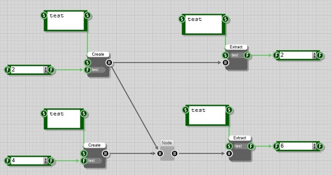

Tepeix
Posts: 361
Post by Tepeix »
I make a little test.
(Was also asking myself if adding stream outside of a code was fast as inside.)
We could see the code generated with the analyzer.
It seams the same with link add, asm or buses.
But the micro cpu analyser have a little more for the buses. (not so much comparing to bigger code)
Comparing the text code, with buses there's 2 more line at the end. A read and write.
test add external to dsp asm.fsm
(90.31 KiB) Downloaded 621 times

Cool test Tepeix 8-)
That's interresting! I wonder why the ASM addition is so much faster than the regular addition...? Or rather why regular addition "is slower".
Does CPU throttling skew the result of this test somehow? As it looks to be using correlation between samplerate and a time...? I have no idea how the analysers work under the hood... :D
I can confirm somewhat that I actually notice a fractional improvement after consolidating my buses, reducing the total amount of packing/unpacking. But it's hardly noticeable... I maybe gained a single voice at around 23 played notes... before my synth starts acting up on my current PC i'm testing on. It shouldn't act up at all, but I think there's some DSP filter in it that performs badly.
