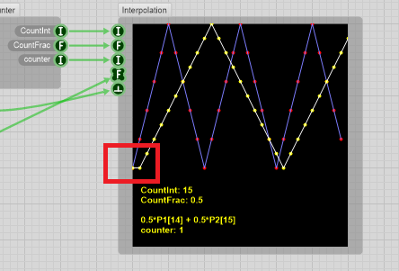

This could create strange artefacts, because if the first sample is 0, it's not a real "interpolation", but seems it "delay" the first sample. I've make a Ruby that show it:
Linear Interpolation Emulation.fsm
(3.52 KiB) Downloaded 1121 times
Is that a normal behaviour of Linear Interpolation? Or due to the "trouble" with Round (that "force" this algorithm to use CountInt 1 based instead of 0) it will introduce this issue?
