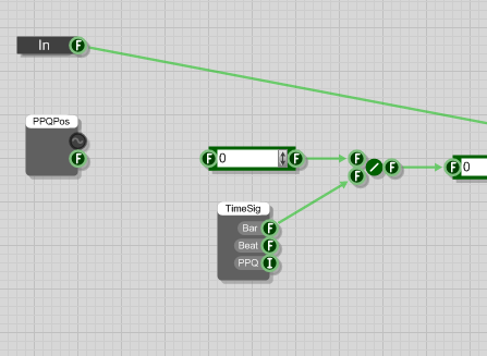

it cannot work because hz is set to 0 when play is on... i also don't understand what you are doing with barposition to phase, this is always 0... you would need to calculate the the correct position in the lfo cycle which is the one i did and acompare it to 0 because the osc phase gets set to 0 when play turns on...
beside that triggering sync with green will not be sampleaccurate so you would need to do all in blue to work accurate and it still will have the issue that it only works when you start playing but not when changing the songposition cursor while playing or when you have a looplenght unequal to the lfo cycle...

It does indeed work. It's just moving the phase instead of oscillating. So while the oscillator does not oscillate on its own, the phase is continually set to the correct position in the song time with the PPQ value. I kind of turned the concept on its side with that but the end result is correct, I promise!
You are correct that it's not sample accurate. I have doubts this is important though. Either way it's limited to PPQ rate, so you won't be doing anything fast with it. I did just drop the stock oscillators in there though, so you end up with whatever shape they produce. Is your design calculating ideal waveforms Nubeat? That could be a benefit if so.
My design was meant to allow for the LFO to function with or without playback so it's serving that purpose for now. Of course there may be a better way of doing it and I'm open to that.
On another note, I just tested your last upload Nubeat (the "FL Studio" version) and the waveforms don't seem to be functioning correctly. The sine and saw only occupy half the range, triangle is working like saw, and square isn't moving. So I think you've got something off in there.

Perfect Human Interface wrote: So while the oscillator does not oscillate on its own, the phase is continually set to the correct position in the song time with the PPQ value
maybe it should but ppq isnt connected anywhere! so lfo stops when play is on...like i already told you the pase connection from 'barposition' module is always 0

Nubeat7 wrote:maybe it should but ppq isnt connected anywhere!
Oh I see now... You downloaded one of Father's examples instead of what I had uploaded.
There's your problem, Mr. Father. ;)
