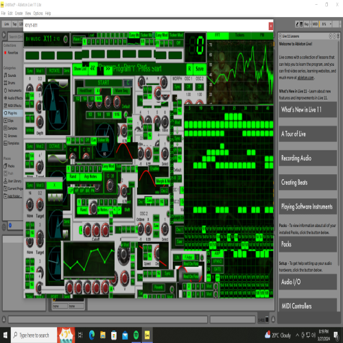

I've created several 64 bit plugs and the results are always the same.
In Reason, they run Flawlessly. :D
In Abelton Live, the graphics are completly F**ked so it's un-useable :cry:
In Fl Studio, has the worst result, where the plugins don't show up at all, not even in the browser. :cry:

billv wrote:In Abelton Live, the graphics are completly F**ked so it's un-useable :cry:
Curious... What happens to the plugin-graphics in the DAW's that actually manage to load the plugins?
Do you have a screenshot?
Try an instance of my plugin (Might take a moment to load though... It's simply the way the plugin is :roll: ). Same result?

R&R wrote:Curious... What happens to the plugin-graphics in the DAW's that actually manage to load the plugins?
R&R
Posts: 474
Re: Flowstone 4 alpha (FS4)
Post by R&R »
Looks like drawing origins are all over the place somehow :D

Thanks for your ongoing help, I have got some good news. :D
In abelton live, in the Options/preferences/Look and Feel.... they have a button that's dedicated
to screwing with the graphics.: HiDPI Mode....turn this off....and problem FIXED.
All the synths(12) in the VST2 folder run Flawlessly.
