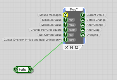

MyCo wrote: If there is nothing else to fix I'll take a look at the mouseRUpCaptured thing
There is an issue with mouse "Drag y" primitive. When the cursor input is set to "1", it hides the cursor properly but after drag the cursor jumps to a wrong position x=0 y=0. Other modes seems to work fine (0=Show and 2=Hide only)
- Drag y_ bug.fsm
- (63.93 KiB) Downloaded 1932 times
