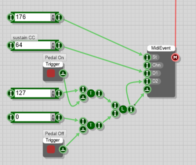

MyCo wrote:Can't test this and it's the first time I heard about that.
Very annoying bug... This is related to "Midi to Voice" primitive.
if active voices (pressed keys) become more than the maximum number of the voice and you use sustain pedal in this situation that issue will reveal.
For example set the maximum number in "M to V" primitive to 3, then play a chord with 4 notes (in this case one voice must be stolen , ok no problem) at the same time if you activate/press the sustain pedal and release the keys then deactivate/release the sustain pedal, You expect muting all notes... but that stolen notes is wrongly played again and stuck ...
Please fix this issue..

iman wrote:For example set the maximum number in "M to V" primitive to 3, then play a chord with 4 notes (in this case one voice must be stolen , ok no problem) at the same time if you activate/press the sustain pedal and release the keys then deactivate/release the sustain pedal, You expect muting all notes... but that stolen notes is wrongly played again and stuck ...
That's interresting. I might be able to track that back even though I can't test it (don't have sustain pedal). So just to make sure I understand it correctly:
1. set max voices to 3
2. play 4 notes (one of them isn't played)
3. hold susain
4. release all notes
5. release sustain -> one note starts playing?

MyCo wrote:I might be able to track that back even though I can't test it (don't have sustain pedal).
No need for sustain pedal, you can emulate it using MIDI CC#64:
MyCo wrote:So just to make sure I understand it correctly:
3. hold susain
Exactly but it does not happen all the times! I don't know how to say it is somehow depends on how you release the hold notes from keyboard (in ascending or descending order). It is totally random you should check out different combinations,, play several notes and release them in different orders and see what will be going on.
Here is a test schematic:
MIDI-Sustain bug.fsm
(20.81 KiB) Downloaded 899 times

Thanks for the test schematic. I found a pattern that always causes the problem now (by just using PC keyboard as midi input):
1. click pedal on
2. play the keys Q,W,E,R one after another
3. click pedal off
Result is, the note of Q-key gets stuck.
We should be able to fix that. Unfortunately I'm not really familiar with Midi/Voice implementation in FS right now, might be something for Malc. I'll ask him.
