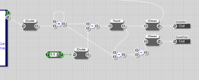

Looks at the Precise Counter module inside it:
if you play the sample at original pitch (step=1 from DSP code), the value of CountInt (which is the index of the sample that will be read by the following Interpolation module; to be precise, that value-1 since is zero-based) will never get odd values :o
Out of DSP Code (step=1):
First iteration: 1+0 (feedback prim), than 0.5 (-0.5), than Round... CountInt=0
Second iteration: 1+1 (feedback prim), than 1.5 (-0.5), than Round... CountInt=2 (BUG)
Third iteration: 1+2 (feedback prim), than 2.5 (-0.5), than Round... CountInt=2
Fourth iteration: 1+3 (feedback prim), than 3.5 (-0.5), than Round... CountInt=4 (BUG)
and so on...
The odd values will never be considered. But it seems that the sample play fine. How can play fine if odd index (reading the wave loaded in memory) will be ignored?
I'm curious about this...

Nowhk wrote:First iteration: 1+0 (feedback prim), than 0.5 (-0.5), than Round... CountInt=0
Are those real debug values or just your estimates?
Round Primitive(0.5) should output 1
Round Primitive(2.5) should output 3
It's not black magic, the Double stream round primitive just uses frndint:
http://x86.renejeschke.de/html/file_mod ... d_110.html
Note to myself: We should change that to SSE2 :mrgreen:

Real debug values (I guess :lol: ):
Bug Round Double.fsm
(6.76 KiB) Downloaded 982 times
Play a note: it outputs 0 (on Round Primitive(0.5) Poly readout) and 2 (on Round Primitive(2.5) Poly readout), not 1 and 3.

This is known as "round to even".
This is done to reduce bias in numerical calculations.
It is not a bug.

TheOm wrote:This is known as "round to even".
It is not a bug.
Oh I see, thanks TheOm. So this is not a bug at all, even if MyCo supposed it here.
Then, I guess that in the new version that seems to be fixed you just change the way "tie-breakinground" is managed: from "half to even" to "half down", right?
Anyway, the problem above stay: the Wave Player never reads odd values, but it still play a sample perfectly.
How is this possible?

I think you have some fundamental misunderstanding here. The rounding mode (like round to even) only affects the behaviour when the value is exactly in between two whole numbers.

TheOm wrote:I think you have some fundamental misunderstanding here. The rounding mode (like round to even) only affects the behaviour when the value is exactly in between two whole numbers.
Yes, Tie-breaking: "Rounding a number y to the nearest integer requires some tie-breaking rule for those cases when y is exactly half-way between two integers — that is, when the fraction part of y is exactly 0.5."
I can have part of y when it's exactly 0.5 in the example: after it get feedback of itself (let say 2), 0.5 is subtracted; thus 1.5 after Round should be 1, not 2:
I'm missing all odd values, since all input is an integer (playing sample at original pitch) less 0.5, in a range between 0 and wavefile size.

But it works out perfectly, see:
CountInt = round(Input - 0.5)
Input is 2, that means CountInt = round(2 - 0.5) = 2
CountFrac is Input - CountInt, which is 2 - 2 = 0.
WavePlayer always reads (1.0-CountFrac) * sample[CountInt] + CountFrac * sample[CountInt+1]
(simple linear interpolation)
which in this example turns out to be:
(1.0 - 0.0) * sample[2] + 0.0 * sample[3] = sample[2]
which is exactly what it should be.
Now try with Input = 3 (odd number)
CountInt = round(3 - 0.5) = 2
CountFrac = 3 - 2 = 1
(1.0 - 1.0) * sample[2] + 1.0 * sample[3] = sample[3]
works exactly like it's supposed to.
