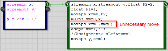

When you inspect the ASM code of a DSP codebox, you will often find unnecessary moves:
This can be a problem for long formulas like evaluationg a higher degree polynomial, where the compiler might run out of xmm registers. Note that you won't get a warning in that case! :mrgreen:

martinvicanek wrote:This can be a problem for long formulas like evaluationg a higher degree polynomial, where the compiler might run out of xmm registers. Note that you won't get a warning in that case!
:D
Good heads-up if I ever get to the point of prototyping more mathier stuff. That overwriting would probably taken me a while to catch... :? or rather would probably have thrown something out the window :lol:
Hmm... so basically I have entire oscillators worth of unnecessary movaps just in all of my synths multi input "range checks" spaghetti (summed together) alone :shock:
I don't know if I should consider this good news or bad news :D lots to do then...

I spot also a strange thing in your code, don't know if it's normal, maybe some ending line are missing ?
With those 2 last :
movaps xmm7,[ebp+4224];
movaps xmm6,[ebp+4208];
you move a memory to an xmm location, but those xmm seams to do nothing with it, are they really necessary ?

Tepeix wrote:you move a memory to an xmm location, but those xmm seams to do nothing with it, are they really necessary ?
Yep looks funky... :) the code wasn't meant to show anything more than an approximation of unnecessary movaps.
Abrupt ending might be that I disconnected the module from its output to connect the analyzer 8-)
I've had chance to convert some more spaghetti to ASM now... with nice results. In some cases more than 1% less cpu when pushing 64 concurrent notes with a selected reference patch. Meaning, on my computer probably 4 to 8 more voices added to max playable voices, depending on set buffer size though. Still nice!
