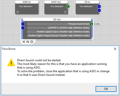

Driver problem in Win-10, here no Asio driver present and any other app started.
Maybe not work whit Nvidia audio driver?
Anyone?

Maybe a compatibility issue? Direct Sound belongs to DirectX. And there's an all new version of DirectX (v12). Or the drivers are not updated to work with DX12.

For Asio... are you sure you have a 32Bit ASIO Driver for your soundcard?
For DX: If I remember correctly, I had a similar issue with Win10. You can fix it by changing the settings of the soundcard in the windows control panels. Not sure about that, but I think it was something like checking/unchecking "exclusive control" and you might have to turn off the audio enhancements that you can find in the same dialog window (different tab) if it is supported. I played with these settings a lot, and after a restart the problem is gone.

Thanks for the suggestions,
tried various settings for the options you suggested, but it still does not work, regarding the ASIO driver on this machine I have no additional sound card, only those integrated into matherboard and Nvidia video card, so I really do not understand the message error returned.
