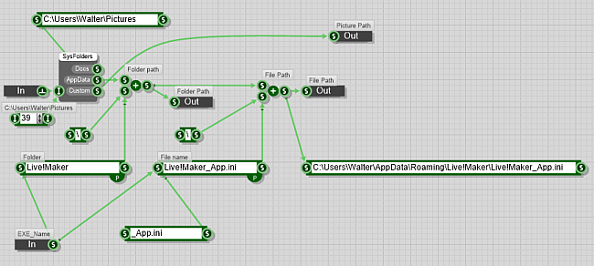

Demanded via PM by RJHollins here my solution capture:
btw: i use Trogs Custom Seetings File manager (with little FS Trigger changed bugs) with it...
Win8(6) i7 Quad
Walter
Win8(6) i7 Quad
Walter
- Walters Sysfolders.png (93.16 KiB) Viewed 16093 times

Good Morning Mr. Sommerfeld,
Thank-you for posting ! I apologize if my PM had any 'demanding' overtone to it ... certainly not my intent
Something very interesting with the schematic you've posted, particularly the TRIGGER INPUT on the SYSFOLDER prim. Maybe someone would explain why this is added
My schematic section in this area looks nearly identical ... heck, I probably saw you posting at the SM forum and modelled accordingly
Again, Thank-you ... I dealing with a most frustrating issue with my beta-testers 2 systems. If it was only one of his computers, I'd say IT had a problem ... but for both to not work ... I've got a code problem I'm looking for ... or is this some kind of BUG
Thanks again.
Thanks again.
