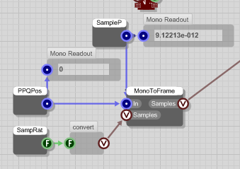

been playing around with the "sample position" primative
Do those two blue streams need some math before they hit the mono to frame?
Is better to re-write this picture in ruby???

billv, I honestly do not understand your timer.
first of all even if you MonotoFrame you set the buffer with the size of the sample rate,
it will still be synchronized with a tick every few sample buffer according to the audio drivers, for example,
every 512 samples, you'll have an update, even if you put 44100 samples, it will be divided into 4 ticks of 512 samples.
then you actually do not use the data for the PPQ or SamplePosition to calculate and send the midi to start,
so do not just simply connect the primitive Framesync, to the module ruby midi ?
So who makes the clock in your case is just that .... but maybe I'm wrong.
billv
Posts: 1165
Location: Australia
Re: VST Timing
Post by billv »
Tronic wrote:billv, I honestly do not understand your timer.
You can see by how I'm now fiddling around with the "sample pos" primative,
in the last post, shows clearly that I don't understand my timer either. :D
But I do know, that the circuit is giving me by far the best results so far.
That's pretty much how I work, trial and error till i get a result.
