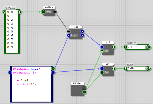

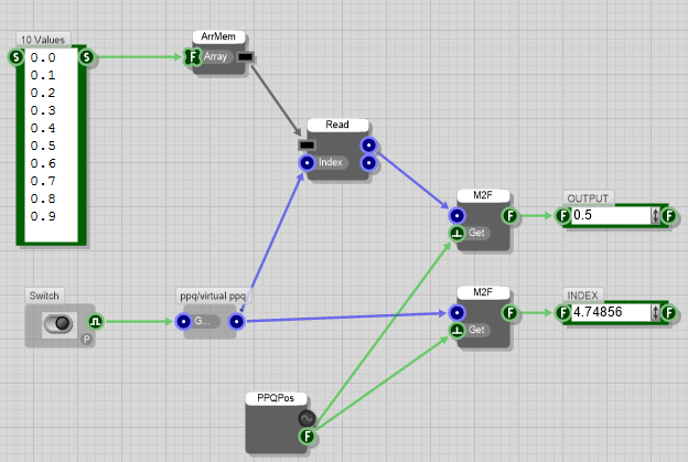

as you can see in the picture: INDEX it is not 5 yet, but it has already read the values from stream at index 5. They seems unrelated.
I guess index 0 is the first sample and index 44 is the 44° sample from stream? Or is here where am I wrong? Using fast speed you won't notice this, but in fact at slower speed its pretty clear.

So, I've place some fixed float value as i. And I've noticed that it reads the samples in a very "strange" way.
These are the results:
fixed i between [0.00, 0.50] => it reads Sample 1
fixed i between [0.51, 1.49] => it reads Sample 2
fixed i between [1.50, 2.50] => it reads Sample 3
for me those values makes no sense at all :o For example:
1 - why second value occurs after 0.50 instead of 1 at the beginning? (this is a huge problem, because it introduces an heavy offset).
2 - why the limits are sometimes 050, sometimes 0.49? (even if this is almost irrilevant; its only an approximation I guess).
How can I make this reading robust?

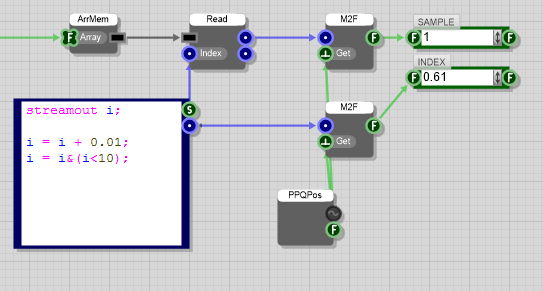

But as I stated above, using this process and the "READ" module seems to sucks. Also in your example this problem happens (using 0.01 instead of 1 as step):
You can see that index is 0.61, and it has already read the second sample (i.e. value 1).
That's because the second sample it's readed at 0.51 instead of 1.00 (0.50 of gap between first and second sample).
Than the gap between reading the next sample is 1, not 0.50 anymore.
I know this won't be a huge problem working on a wave with 1024 samples, but if I've these troubles at the beginning, they would become precarious.
I want to understand why it reads the samples in this way, for my future applications.
Is it a bug? Or is it a sort of math approx?
Because if it's correct, ok I can use it now and forever.
If it will change in the future, that's would be a problem. Any clues?

Well, I don't know the trick of /44100 and get 10 seconds (and I don't care right now), but what made the trick is that "-0.5" linked to the Read module: now the results seems correct.
In fact, it makes correct result even with my old code, using 0.00001 as increment inside DSP code.
Now please (pleaseee) explain to me: why there's that "0.5" offset in the Read module? Is it a bug or somethings that I don't get in any way?
Its a problem with my mind: I need to understand things :D
I really don't get why of that offset... shine me!!!

Post by nix »
10 seconds is 441000 samples
The .5 was needed because of the way the reader receives a stream integer,
even though it is just a blue mono dot. There are only polyint connector types.
The stream needs to be reduced by .5 because of a rounding error on the integer(whole number) conversion,
you know, like .6 rounds to 1, but .4 rounds to 0
So nice it's working now! You just need to be able to set bpm and be samplerate independent
