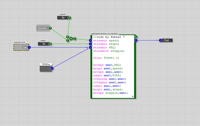

"did you unwire the pseudo host inside the ppq sync module? there you need to connect the timesig from host and the host ppq primitive, i was using a pseudohost module for testing inside FS, forgot to unwire this"
What do I need to change for this to work , what can I connect instead of the Pseudo host , I am a bit confused by this ,will it not run without the pseudohost in FS ?
EDIT: I see, It runs in a daw when hooked up properly , just needs the pseudohost for running in FS.
Re: Position Synced StepLFO
Posted: Thu Dec 06, 2018 9:55 am
by Nubeat7
You are right, the pseudo host just imidates the playpositionmarker of a daw, it also is purgeable, so it will be deleted when you compile your project. Then, when be used as vst, it will use the ppm from host.
