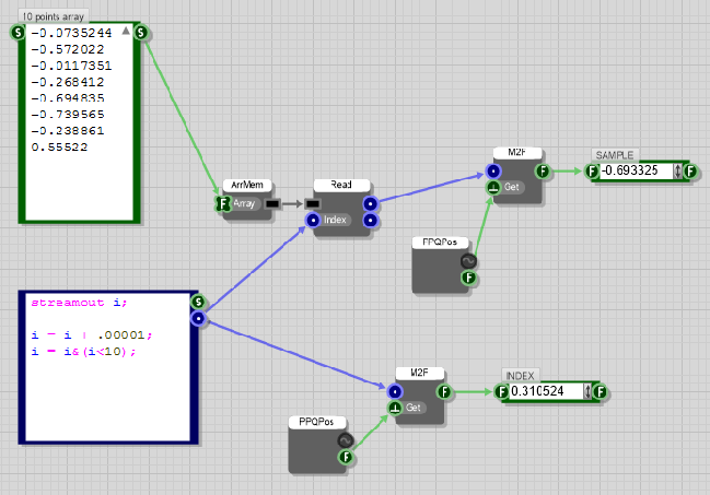

Anyway I think I'm making some other mistakes:
Without rely on Graph (I removed it; could be delayed as suggested), every time an integer in INDEX module is outputted, I should immediatly see the current sample of that index changing in the other SAMPLE module.
Instead they are way (waayy) to async. What am I missing dudes? Its somethings like 3/4 seconds delayed. Too heavy...
schematic.fsm
(718 Bytes) Downloaded 906 times
can't figure it out! :(
I guess that:
when i==0 output => -0.693325
when i==1 output => 0.755871
and so on. Instead it "change" around i=1.78 for example, and the first step is quicker than the others (i=1 happens quickly).

Yep- only streams use samples.
I'll have a peek at your schematic over the weekend

hmm-
can I get the whole LFO schematic?
Do you need to use ppq?
ps- when you use .00001 as the counter iter,
it takes very long to count to 1, which is where it will register an integer step in the wave read

Hey again Nowhk,
I saw your post at Fruity, so I learnt more about the ppq hack.
Here is the counter I have modified->
schematic_integer.fsm
(1.15 KiB) Downloaded 952 times
So the string array and the counter read the same.
Does that help?
http://imageshack.com/a/img633/1214/qJgkVp.png

This might help.
Check the blue section in this modulator. (It's an old 'myco' circuit from way back.)
schematic_bv.fsm
(277.2 KiB) Downloaded 1057 times

Uhm, I don't understand your schematic: it's identical to mine! And in fact using "i + .00001" I've the same problem.
billv wrote:This might help.
schematic_bv.fsm
Uhm, not really :o The method is the same (stream->read mem->ppq tick->out), but the problem is that the index/output of the stream seems not aligned with the DSP code. I can see the values change, but not at the correct integer time/index :cry:
