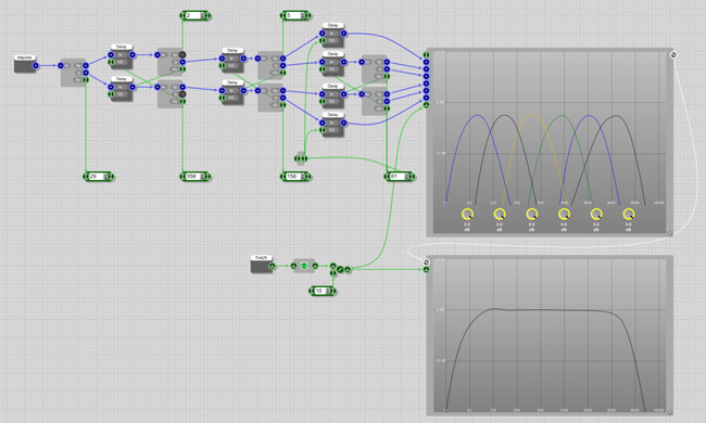

What if opting for a phase-linear 6-band splitter, costing almost the same CPU% than a 4th-order Linkwitz-Riley one (that's not phase-linear)?
See it here:
Bandsplitter - Lipshitz-Vanderkooy - 6 bands (bandpass) (650 pix).jpg (67.32 KiB) Viewed 13971 times
Have a nice day

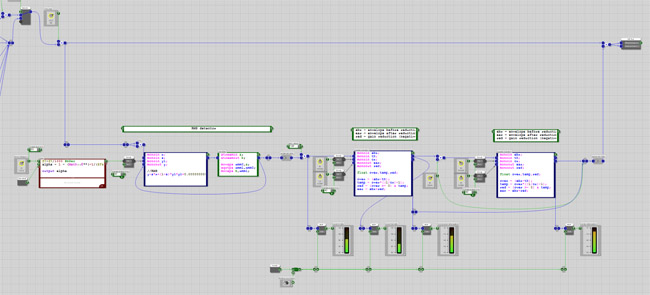

What if opting for a compressor-limiter, per channel, that's embedding the channel gain control?
hearing aid RMS det comp gain lim.fsm
(18.05 KiB) Downloaded 951 times
hearing aid RMS det comp gain lim.jpg (650 pix).jpg (56.34 KiB) Viewed 13971 times
Have a nice day

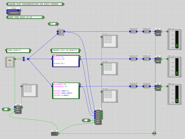

I understand the audiophile preoccupation of managing the compressor-limiter side-chain in dB domain instead of in LINear domain. Unfortunately, the lin2db block and dB2lin block appear to be CPU% hungry. Times six, in case there are six channels.
There exist various analog audio compressors-limiters, that are managing the gain (attenuation) in various unspecified domains defined by some vacuum tube in low V anode-cathode region, some JFET in low VDS region, some BJT in low VCE region, some vactrol (LED + LDR), etc. all recognized as working satisfactory. All providing transfer curves lying between "log(x)" and "sqrt(x)".
Speaking of digital, why not trying the sqrt(x) domain?
I am making such proposition, because the Flowstone Assembly Code component supports the x86 sqrtps xmm1,xmm0; instruction, much faster than a lin2db block. Consequently, the side-chain can manage the gain (attenuation) in sqrt(x) domain. At the beginning of the side chain, instead of placing a lin2db block, we place a sqrt(x) block, much faster than a lin2db block. At the end of the side chain, instead of placing a db2lin block, we place a x^2 block, much faster than a db2lin block.
I am attaching a .fsm, showing the validity and precision of the x86 sqrtps xmm1,xmm0; instruction.
sqrt(x) function for audio.fsm
(12.08 KiB) Downloaded 926 times
sqrt(x) function for audio (650 pix).jpg (100.12 KiB) Viewed 13967 times
Have a nice day
