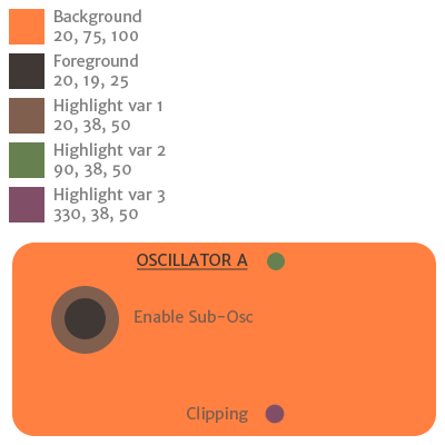

Let's imagine someone's preferred color would be a nasty orange. I know, who would ever prefer such an eye-hurting color? But still, let's just assume there would be one person in the whole wide world. How would the color palette look like if done similar to Sinner? Like so:
In this case the dominant color is also the lightest instead of the darkest, etc. Everything is reversed. And doesn't it look beautiful? Apart from the orange of course which is still burning my eyes...
