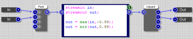

The Dreadful Stereo Clipper
I often see this dreadful stereo clipper module in schematics right before the audio output:
To be sure, it is a good idea to have a clipper there in order to prevent overloading the hardware, which would sound much worse! Of course it is best to stay within the (-1,+1) range in the first place, so the clipper is just a safeguard.
So why do I call it dreadful? Because it is extremely inefficient! Ironically, the design indicates an intention to save CPU by exploiting SIMD for the two min/max operations. However, due to the overhead from the Pack/Unpack modules the savings are more than undone: the dreadful stereo clipper uses 85 cycles on my computer. To put this into perspective, you can build a 4-band parametric EQ with less CPU cost!

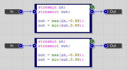

Actually you would be much better off with a naive replication of two clippers (15 cycles):

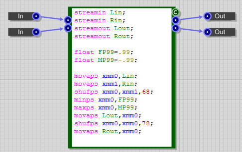

That's not bad, however if you really want to go efficient I'd recommend this optimized stereo clipper (4 cycles):
Here is the code:
streamin Lin;
streamin Rin;
streamout Lout;
streamout Rout;
float FP99=.99;
float MP99=-.99;
movaps xmm0,Lin;
movaps xmm1,Rin;
shufps xmm0,xmm1,68;
minps xmm0,FP99;
maxps xmm0,MP99;
movaps Lout,xmm0;
shufps xmm0,xmm0,78;
movaps Rout,xmm0;
Last edited by martinvicanek on Tue Jan 26, 2016 10:17 pm, edited 1 time in total.

Hi Martin,
GREAT post !!
Very informative, my experience has been that the pack-unpack routine usually encompasses a much larger schematic and the 'stereo clip' module is just a safety valve at the end of the schematic, so overall, the clock overhead would only rise by a tiny percentage.
Very informative though, that you show us how clock cycles add up while we're not looking !
It's nice that you offer a mono schematic and an optimized stereo pair.
I would be very interested in learning how you measure clock cycles.
If you have a minute, could you spell it out for us ?
Thanks-a-plenty,
ROXY
