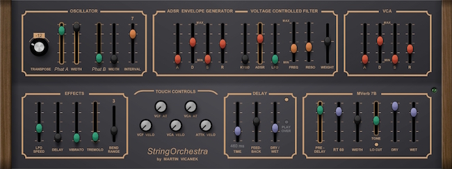

I was a little unsure if 'Randy 2' is intended to supplant 'String Orchestra' or what - Martin said back in Nov. that he was 'adding stuff'; is that what became 'Randy 2'?
Anywho, I did a third version of SO, with a second 'generator' that can be tuned to semitone intervals with the first and has it's own Phat and Width controls. With this tuned to say a fifth above, it's Phat and Width at near minimum, one gets almost a soloist-with-orchestra effect. Also added a LoCut to the wet of MVerb 7b; keeps things from getting muddy with bass-heavy sounds - also sounds more like a real world concert hall. Most good halls have much less reverberation at lo freq than high.
StringOrchestra2 copy.jpg (141.16 KiB) Viewed 21333 times
SOS_arpGUI_d2.fsm
(2.06 MiB) Downloaded 1266 times
I really love this thing. Haven't explored Randy2 yet.
