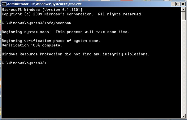

RJ; are you aware of "sfc /scannow",...
The sfc /scannow command will scan all protected system files, and replace corrupted files with a cached copy that is located in a compressed folder at %WinDir%\System32\dllcache.
I used it before and it worked great..Google it to learn more.

Re: GreySynth
OK ... ran the CMD sfc /scannow app.
Result ... No integrity violations.
Still need to purchase a USB stick to do the RAM test.
