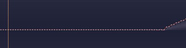

So here is the real story.
this is my timer at the very last sample before display dissappears
And here it is all the way

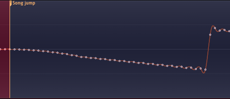

And here is Stock VSTi. Look how far out it is...
Re: Stock VSTi Fails Timing Test Using Host Seq
Previous post re-tested and confirmed again.

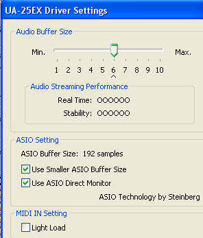

Is your soundcard set to use a 64 sample buffer?
Is that delay pretty much the same every time?

trogluddite wrote:Is your soundcard set to use a 64 sample buffer
Tried pushing the slider to min, gets me 94.
Do I have to be at 64?
What are the ramifications here?
