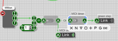

nix wrote:In that schematic, the example synth-
Nix, The picture I took was from the Sampler ...... Not the example synth....

I had unhooked the timer,
trying to locate the component causing the crash.
That timer gives a tick to the m2f in mod,
which translates the stream into green,
which triggers the random step LFO changing to a new random array, and updates accordingly in the graphic.
