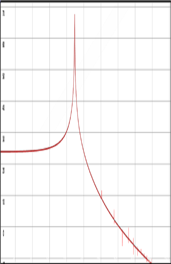

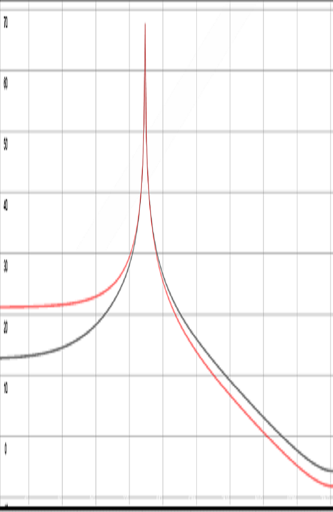

Also, im ashamed to say, im getting worrying results from my tests with a compressor.
Ive made a really simple compressor and tested it with a FFT .
So in the pics the RED signal is WET (running through the comp)
And the BLACK is the DRY (dry like a bone)
PIC - 1 dry - Thresh:0dB Ratio: 1:1
PIC - 2 Thresh: -20 Ratio: 2:1
As you can see from the results, on one hand it is attenuating frequencies that I dont want it to, PIC1- Its dry here so should NOT be attenuating. On the other hand its introducing freq spikes when ratio is active.
Ive made the compressor clean as possible. That I could think, here is how it flows. . .
IN--(abs)--(lin2dB)--(Gain Reduction)--(Envelope)--(dB2lin)--(VCA)--OUT
So my VCA is attenuating the dry signal.
Anyone had a similar problem?

That doesn't necessarily explain the frequency differences though - unless you have filters in there, the gain should be the same at all frequencies. Without seeing your schematic, it is hard to know exactly why this is - but here are my top two guesses...
1 - The sound at that frequency is just too loud, and overloading the FFT. Off-the-scale a lot and off-the-scale a little bit are just off-the-scale full stop - so the peaks would look the same even if one really is quieter than the other. Could be a side-effect of dividing the dB numbers.
2 - The Attack and Release are way too short. Once they get very small, the attack and release start to track the individual peaks of the sound waves, and this can make the envelope start to behave like a filter. This problem will be worse if the input level detectors also use a very short averaging time.
The spikes are most likely aliasing distortion - which suggests that something is overloading somewhere. Again, this could easily just be the FFT being given a signal which is too 'hot'.
Best bet would be to upload your schematic - it is much easier to diagnose the problem when the design can be opened in FS for a poke around inside.

0dB might be a little hot still (for the FFT, not your schematic), and IMHO a 10ms release is rather fast - you'll almost certainly be getting a little bit of gain-riding on the individual cycles at 440Hz, which may explain those small frequency peaks on your FFT.
Had a quick look at the schematic you 'Dropboxed' - and I have to say, it looks very good. I stuck some tests into each module in turn, and your assembly is all working very well; nice job!
A couple of comments - though as you only showed a part of the schematic, this is maybe stuff that you have already sorted...
The one thing I would add is to return the 'averaging' to the detector - although the envelope generator will smooth the GR values, the dB section is unlikely to work properly unless it is given a good chunk of the waveform to average over.. As it is, the dB value will be bouncing up and down like a yo-yo, making life hard for the envelope - and this will lead to some modulation of the signal that might give you some distortion.
That will be even more important if you use it for an auto-gain feature - you really must compare the average levels of the two signals for that, as if you compare sample-by-sample, any effect that changes the phase of the signal (e.g. most filters), will result in a much bigger difference value than you would expect.
