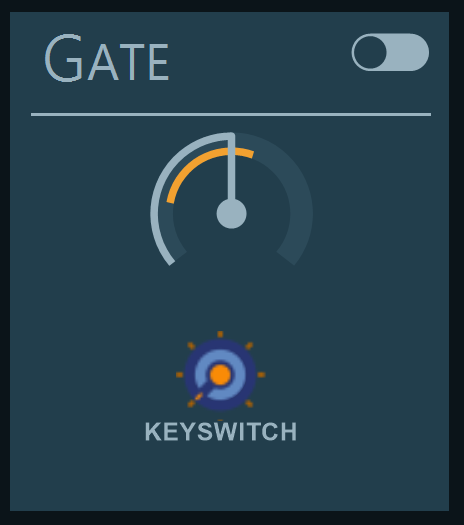

For this project I'll go with 100% runtime-drawn (aka vector) graphics. The reason being simple. In Flowstone 4 we will be able to resize our plugin to any size we want. And runtime graphics are the only hassle-free solution.
With bitmaps you either have to live with low res, blurry graphics when displayed larger, or you have to waste lots of plugin data size and memory, holding larger copies to keep at least a bit of the sharpness.
With runtime graphics, you don't have an issue. On every redraw, all individual elements that compose a knob or slider or switch etc, are actually drawn, not taken from a bitmap and scaled to fit. The advantage is obvious: Because everything is based on grid steps, when resizing the grid step is increased/decreased, and all drawing fits to the new size automatically - with the same code! You only compose a button once, and it draws at any resolution in the same quality.
Here is an example with runtime graphics and inbetween one bitmap knob. Both are created only once. Then I increased the size.
There are a lot more advantages of course. Skinning your GUI? A breeze. Just change the colors or the dimensions, etc. No new bitmaps needed. You notice during development, that you made a mistake, and all your knobs need to be 2 pixel smaller? Good luck with bitmap strips. Runtime-graphics just get the new size input, and that's it.
A future-proof GUI needs to be runtime-drawn. And this GUI will also heavily rely on Windows 10. The market share of all older versions is marginable, while Win 10 has a share of almost 80%. Speaks volumes.

how does flowstones vector gfx heavily rely on win10?

Cool stuff Tulamide !
I have been looking into blending vectors and PNG's, so just using the png for shades and shadows .
There is a very nice plugin for both After Fx and illustrator to animate Rlottie Files.
In fact it would be amazing to be able to import Rlottie Files into FS, Rlottie/JSON files are just Vector animations , so you could use programs like Illustrator rather then using paint ruotines.

Lottie/Rlottie support has to be implemented on the source code layer, I'm afraid (or maybe as a dll, that you access via winlib, if timing is defined in the dll). The problem is that animations need a (reliable) timer, and that would mostly mean a seperate thread at least for those animations. This threading can only be implemented in the source code.
Regarding shades and shadows, you don't need bitmaps (well, you do, but only as seamless textures), because you can set both, brush and pen to use a texturebrush in Ruby. A simple disc with a gradient from shadowcolor to transparent would do the trick. You can then draw lines underneath the borders of your shape, and it will be a convincing soft shadow.
But yes, as of now, it's all to be handcrafted, I'm afraid. FS4 will offer to import svg files, but it just creates a bitmap and draws the svg into it, so that is of no help. And a Ruby svg interpreter is too much work than I would be willing to do. Probably several months. A guy with more stamina would need to do that, but I'm not sure, Trog ( :mrgreen: ) would be willing to sacrifice his time for such a complex project!
