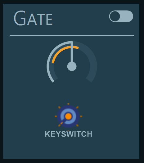

For this project I'll go with 100% runtime-drawn (aka vector) graphics. The reason being simple. In Flowstone 4 we will be able to resize our plugin to any size we want. And runtime graphics are the only hassle-free solution.
With bitmaps you either have to live with low res, blurry graphics when displayed larger, or you have to waste lots of plugin data size and memory, holding larger copies to keep at least a bit of the sharpness.
With runtime graphics, you don't have an issue. On every redraw, all individual elements that compose a knob or slider or switch etc, are actually drawn, not taken from a bitmap and scaled to fit. The advantage is obvious: Because everything is based on grid steps, when resizing the grid step is increased/decreased, and all drawing fits to the new size automatically - with the same code! You only compose a button once, and it draws at any resolution in the same quality.
Here is an example with runtime graphics and inbetween one bitmap knob. Both are created only once. Then I increased the size.
There are a lot more advantages of course. Skinning your GUI? A breeze. Just change the colors or the dimensions, etc. No new bitmaps needed. You notice during development, that you made a mistake, and all your knobs need to be 2 pixel smaller? Good luck with bitmap strips. Runtime-graphics just get the new size input, and that's it.
A future-proof GUI needs to be runtime-drawn. And this GUI will also heavily rely on Windows 10. The market share of all older versions is marginable, while Win 10 has a share of almost 80%. Speaks volumes.
