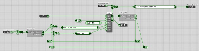

I could use some guidance/critique if this is a proper technique.
Here goes. In supplying SAVED file PATHS back into the FILEDIALOG prim ... like this:
Is this the best way to get PATHS that is saved/loaded from a TXT file, back into the FileDialog to set a default ?
Obviously ... asking because this seems like it should work ... but it ain't really :|
Thanks for any help.
Here's the sample schematic:
Default Directory-3.fsm

Gee ... not even a reply :oops:
Not even, 'that's the ugliest schematic ever seen !' .... just terrible ! .... nothing ? :|

For some reason, the FileDialog PRIM just doesn't seem to use the 'default location' connector properly, or I'm doing something totally wrong in the sample schematic I posted above.

in your schematic you don't save the last used path to any file or in any REG in the registry,
and you have to reload back it when restart your app,
there is no magic that FS can do.

Guys ... the schematic example was just that ...
The WIRELESS connectors are from a SAVE/LOAD module [very standard text file]. I just didn't include that to keep the post simple.

Don't feel offended, RJ, but for me the whole page 3 doesn't make much sense.
You post a low res image of just a part of the whole system that works together. And when it comes to the point, where you would like to get some help you say: "It ain't really working."
That's nothing I would waste my time on.
(1) Post a schematic that clearly shows the issue(s)
(2) Describe in detail, what you expect that schematic to do, and what is not working correctly.
To the point, and with as much information as needed, then you might get more help.

...only mention again like tulamide and i did before:
get rid of the loop back folder splitter (including the 4 nodes)
and it should work...!
1st trigger the ini load
2nd open file dialog
3rd if done save ini...
