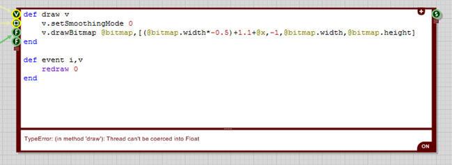

I get a Ruby error in module HorSliderX | Bitmap
Ruby error.jpg (50.73 KiB) Viewed 29500 times
Version 3.08.1
I don't know Ruby so I can't sort it myself but I bet tulamide can...
Re: Combination Circuits/Schematics
That's a known bug that has been resolved in 3.0.9, if I'm not totally wrong.
It's @x, this variable is always interpreted as the Ruby thread. Just use another name for that variable. Avoid @x under all circumstances in 3.08
EDIT: More accurate, rename the input from "x" to something else and all code parts that refer to this input.

tulamide wrote:That's a known bug that has been resolved in 3.0.9, if I'm not totally wrong.
Thank you tulamide, was not aware of that.
