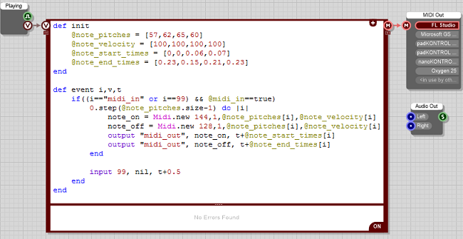

Let say I ignore for now to understand "how things are programmed inside FlowStone". I still really don't know where I am wrong here, because I'm not able to keep sync Ruby timing with MIDI that will be trasmitted (outputted) to the DAW (FL Studio). Ruby Code is very basic:
def event i,v,t
   if(i=="midi_in" && @midi_in==true)
      setupMIDI
      0.step(@note_pitches.size-1) do |i|
         note_on = Midi.new 144,1,@note_pitches[i],@note_velocity[i]
         note_off = Midi.new 128,1,@note_pitches[i],@note_velocity[i]
         output "midi_out", note_on, t+@note_start_times[i]
         output "midi_out", note_off, t+@note_end_times[i]
      end
   end
end
def setupMIDI
   @note_pitches = [57,62,65,60]
   @note_velocity = [100,100,100,100]
   @note_start_times = [0,0,0.06,0.07]
   @note_end_times = [0.23,0.15,0.21,0.23]
end
where midi_in is a bool and midi_out a MIDI connector linked to a MIDI Out prim (which output MIDI to FL Studio). Once I trigger the bool, it sends 4 MIDI notes to DAW that play (each) a simple sine wave within a plugin (Sytrus in my example).
If I record some shoots of these 4-note-score provided by the script above and I play together two of them (one with polarity reversed) I don't get a NULL test: I hear a bit of audio. They are quite similar, yes: but they must be "equal".
Thus, I'm not able to sync MIDI with Ruby timing, or I don't know what I'm missing. Any clues?

For help the "investigation", here's two example!
One for FL Studio owner (basic Patcher with Sytrus and no addittional plugins):
MIDI Sync.zip
(10.64 KiB) Downloaded 957 times
and the same schematic that works in FlowStone standalone (which will play/send MIDI to Microsoft GS Wavetable):
MIDI Sync.fsm
(570 Bytes) Downloaded 946 times
both are out of sync during playing (press play on FL Studio or switch the boolean to True in the schematic). Or I am wrong in some places or FlowStone/Ruby can't sync MIDI properly :(

Yes, but thats about green and problem on alignment/PPQ when I trigger a note. My problem is different: the MIDI notes created at every "Ruby recursive call" plays different between each others (start at different times). So once the loop starts I can hear (during the time) different sound (which I shouldn't).

Here's the recording (MP3 192) of some bars after pressing "play" in my DAW:
recording.zip
(174.57 KiB) Downloaded 981 times
near the end it becomes somethings like a swing :shock: Huge async...
