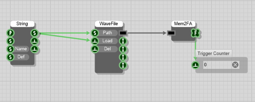

This is the way I process it:
why this happens "sometimes"? Try clicking on the Trigger many times (10/20 times): at some points you will see the value of tdiff with the value, and if you looks at the times, they are different (looks at the pic). I don't know where the issue born...
Maybe it process "[F]" (update) at different ticks of I (stereo) in Ruby's event stack? So that difference in time? How can I fix this? Double flag?
test.fsm
(1018.49 KiB) Downloaded 976 times
(note you need to put some samples path inside the array to switch random to them and looks at the results. Try with samples with huge size for better results)

Nubeat7 wrote:there are two ways to fix this, program the wavedrawer in a way where it doesn't matter what the stereo flag says
:shock: How do you decide if the wave is stereo or mono without this info?
Nubeat7 wrote:so the first connection of the channels output goes to your ruby wavedrawer and the second triggers the sample and hold to send the wavefile to the wavedrawer...
Sure :) But as I said before, this only happens when I load a sample from Wave Loader. Instead, when I just load the schematic, the "stereo" field won't be triggered to Ruby (it just read/refresh value on the connector->@stereo; no trigger happens). That's the problem...
Also, it's strange enough that Mem (which takes couble of ms to read/send [F] to Ruby) happens at the same time of Number of Channels trigger (when they happens together). Or is it the time Ruby will read from connector at fixed tick?
I thought that once Ruby reach a trigger, it just process the event one after one. But it seems it stacks them and process at fixed tick (I guess; it is not written in manual, I don't find this information).

Yes I've thought about it, but I don't know if that's the right choice.
What's the best approch in this case? Invoke the drawing on "stereo" connector and set an After Load to it?
Because my worry (since I don't get how Ruby schedule the events) is that can also happens that "stereo" will be triggered before "samples".
In few words: is it possible that WaveFile's final destination trigger is "stereo" before "samples"?
Or the order on where the connector trigger arrive to Ruby follow the order on where they are placed from the Prism (WaveMem is on top than Number of Channel, that is in the bottom)?
Posted: Thu Jan 28, 2016 5:50 pm
Nowhk wrote:What's the best approch in this case? Invoke the drawing on "stereo" connector and set an After Load to it?
