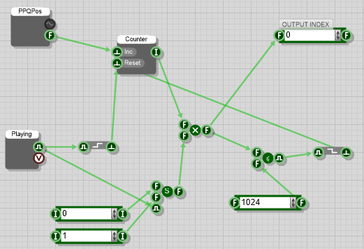

This is the idea I have:
PPQ run at Tempo project (so I guess it is sync enough).
1024 is the max range, than I restart the index (I could set it dynamically if I need less/more samples).
"Playing" will start/reset the index of the array when the DAW start.
I could place a math function to slow down/up the speed of PPQ (so it is not sync with project, but I can choose different ranges) and than (at every OUTPUT INDEX) read the value from the array of samples I've build thanks to the OSC modules (even if I've not idea how to do this in this moment without ruby).
Can't work in this way? Will suffers asynch?
fl index ppq.fsm
(397 Bytes) Downloaded 950 times
