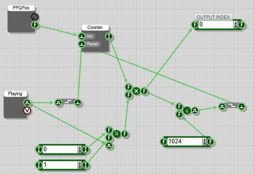

I don't mind so much for the progression bar and LFO Graph. This can be "unsync", is just for visualization.
What should be in sync are the 1024 samples that I'll send to the output to automate knobs/sliders in my DAW. Those must be strong sync!!!

This is the idea I have:
PPQ run at Tempo project (so I guess it is sync enough).
1024 is the max range, than I restart the index (I could set it dynamically if I need less/more samples).
"Playing" will start/reset the index of the array when the DAW start.
I could place a math function to slow down/up the speed of PPQ (so it is not sync with project, but I can choose different ranges) and than (at every OUTPUT INDEX) read the value from the array of samples I've build thanks to the OSC modules (even if I've not idea how to do this in this moment without ruby).
Can't work in this way? Will suffers asynch?

Using PPQ as reader clocker seems not so inaccurate anyway. Maybe it could works...
At which clock/speed a DSP code module process iterations? Its a fixed one or it depends due to the CPU I'm using?
That could be a problem if differs between machines... because can output values at different time.
