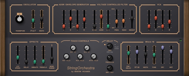

While awaiting Martin's additions, I added for my own enjoyment a simple Delay to this - since this has a built-in reverb, and delay is most effective before reverb; so here 'tis:
StringOrchestra copy.jpg (145.25 KiB) Viewed 22709 times
