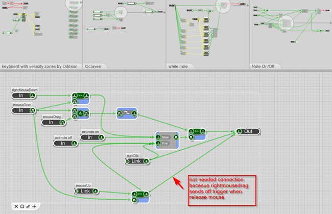

there is a note off triggerconnection from mouseLup which produces a 2nd note off trigger, the note offtrigger is already done by mousedrag which sends a bool to off when release the mousebutton..
don`t know if this also fixes the disappearing gui bug..

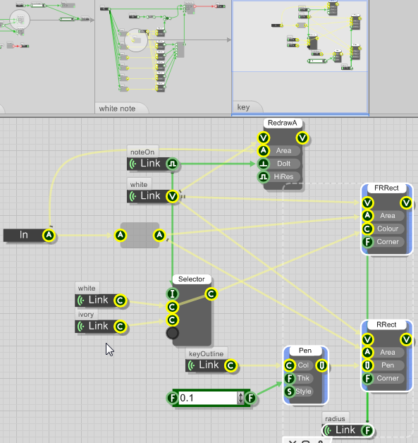

yes its transparent, someone modified it like this.. in the white key draw part there should be a selector which reacts by note on bool and changes colors between white and ivory.. but you also could just underlay a rectangle with keyboard size and the preferred color, which i think was the plan of the mod..
about the note off message works fine here also without the m-audio mod, anyway in the incoming notes module the note off trigger is also sent when data 2 is zero
