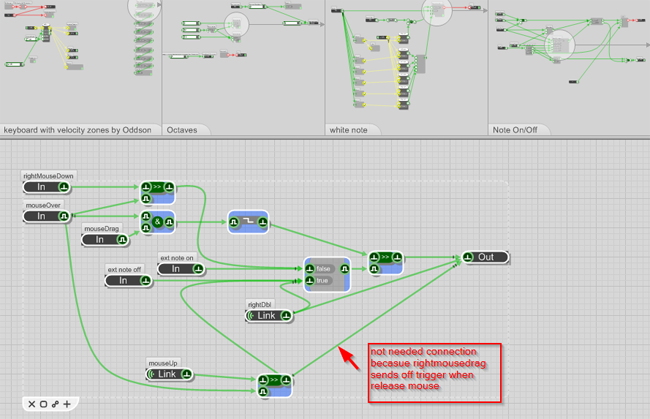

there is a note off triggerconnection from mouseLup which produces a 2nd note off trigger, the note offtrigger is already done by mousedrag which sends a bool to off when release the mousebutton..
don`t know if this also fixes the disappearing gui bug..

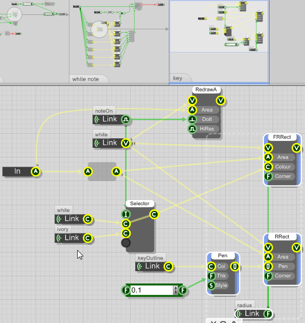

another thing i have noticed is that pressed keys on the GUI keyboard are transparent so there appears to be something wrong with its animation. is anyone else seeing this too?

yes its transparent, someone modified it like this.. in the white key draw part there should be a selector which reacts by note on bool and changes colors between white and ivory.. but you also could just underlay a rectangle with keyboard size and the preferred color, which i think was the plan of the mod..
