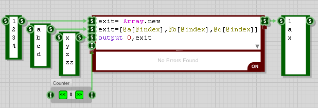

tester wrote:How to fill the array with nils,
That's where i started after my last post....
It's only way to make transpose method work..
Got it working...but its not pretty...
def init
  @a = [0]
  @b = [0]
  @c = [0]
end
  if @a ==[] then @a =[0] end
  if @b ==[] then @b =[0] end
  if @c ==[] then @c =[0] end
def event i,v
  if i == 0 or 1 or 2 or 3 or 4 then
    findlength =Array.new
    a1max = @a.each_index.max
    a2max = @b.each_index.max
    a3max = @c.each_index.max
    a = @a.length
    b = @b.length
    x = @c.length
    findlength =[a,b,x]
    c = findlength.each_with_index.max
    d = findlength.each_with_index.min
      if c[0] != d[0] then
      @b.fill("nil",a2max+1..a1max)
      @a.fill("nil",a1max+1..a2max)
      @c.fill("nil",a1max+1..a2max)
      e = Array.new([@a,@b,@c])
      f = e.transpose
      column = f[@index]
      @q = column
        output 0, @b
        output 1, @a
        output 2, @q
end
watch @q
end
end
really seems like too much work using transpose...so I'm cheating with this...
Hope this helps ...
