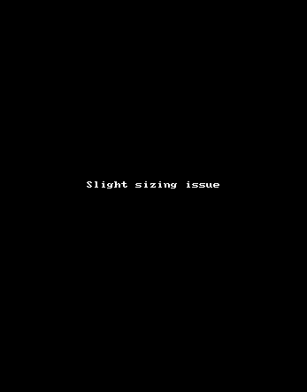

Slight issue, I can size the top box smaller then the other ones , know why that is ?
This makes it so that I cant stack them close together if they are in these dimensions.

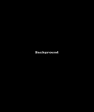

Also , it might need a Sizeable background Png for framing in the Selection png´s
Sorted the background issue, stacking issue not clear to me, too spaced apart.

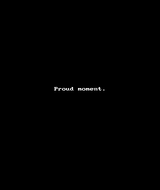

I am pretty proud of this !
Getting better every day.
Two problems ,Lets say I select Alt single for one dot , and then steps for another , when I select it another time the list should reflect what was selected previously for that dot . Now I have the info in the dot but cant seem to update the list with that info when a dot is selected. So basically it shows what was last selected rather then me being able to input specifically what I want it to show which is what has been selected previously , hope i am being clear
i can make it show it but there is a triggering issue as it just blinks in and disappears but show the corrct index.
Also, would like to be able to designate an area around the dot where if I move the mouse out of that area the list closes, in case i decide to change nothing, Also do the same on a right click ...this list as it is, assumes you always select something.
Working on it but tips appreciated as this will be an ongoing problem with this list.
