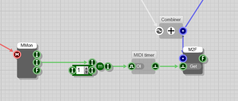

OK,
I have made a testbench example.
This is the example synth by RDSP->
(edit-get the simplified one a couple of posts down)
I have added the Ruby timer to it.
To do the test, export it as VSTi twice,
with different names.
Load both in host, and give each a MIDI note on.
It should crash then.
It does unfailingly in Orion.
So I dunno what we're looking at here,
but since this example crashes,
it simplifies it from my complex synth.
Let me know if it's crashing your host if u can spare the time.
Trogs, the VSTi I sent u, there is a mistake generating the random step LFO,
it runs far too quickly coz the math giving hz is wrong,
but this is not the source of the crash.

Here I chopped out the m2f-
but kept the crash->>
(edit-get the testbed a little further in the thread)
The little mod doesn't do anything-
but irrespective of that,
it's something that IMO shouldn't crash by rights.
One example of it's use is an m2f,
a reasonably time accurate stream sampler.
I was looking at your fix,
thanks for the help,
I'll certainly try and make the thing sample accurate,
so the start is peachy,ta

Re: Are my Ruby codes correct?
Posted: Sat Apr 06, 2013 11:58 pm
by nix
OK,
I removed some components,
and the MIDI out part->
host crash example2.fsm
(96.4 KiB) Downloaded 933 times
So there are less complications now.
Yeah Bill, Entrancer hangs in alright on it's own,
but if you try and run that sampler conjunctively,
it hangs in Orion anyway.
Thanks for the heads up-that's cool though.
edit-It was crashing in EnergyXT2 too.
But I have found something.
It seems that as long as the code's names are unique,
it doesn't crash.
For example-
initaa
eventaa
in one plug &
initbb
eventbb in the other
hmm-will keep testing
