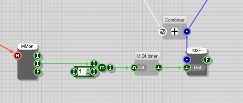

Here I chopped out the m2f-
but kept the crash->>
(edit-get the testbed a little further in the thread)
The little mod doesn't do anything-
but irrespective of that,
it's something that IMO shouldn't crash by rights.
One example of it's use is an m2f,
a reasonably time accurate stream sampler.
I was looking at your fix,
thanks for the help,
I'll certainly try and make the thing sample accurate,
so the start is peachy,ta
